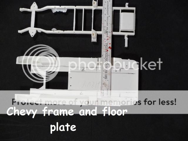

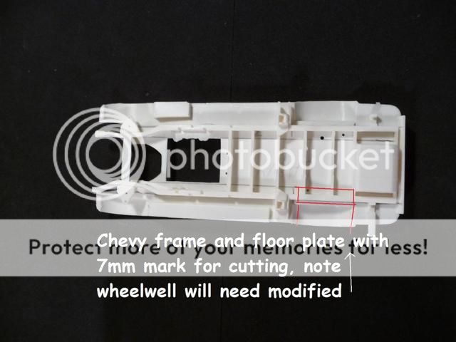

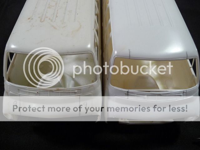

Haven't found my literature but took some engineering to some vans that I have. You have some major sectioning to do after I looked at what the kits offer, Your going to need at least two chevy vans to get the windshield frame to work. Your 14 inch stretch or fattening looks like its easier to do on the floor plate in a straight line on both sides
I would cut on floor for the edges and the second floor used as the center so you don't loose the doghouse and seat positions. You will need to modify the rear wheel wells

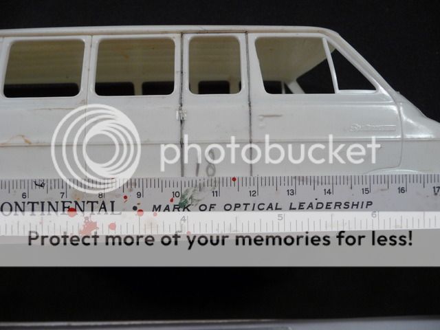

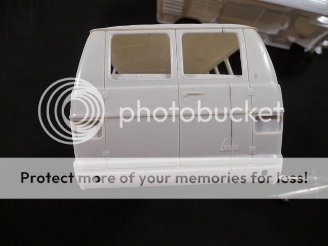

Now the Dodges that I had seen I thought that they used the midsection side piece for the widening of the rear door.In scale that is 18 inches making the 'fattening' nine inches on each side
This makes the driver side rear door about this wide. If I did this project I would section the front to use the ends of the hood and try to keep the windshield curve as curved as possible.
