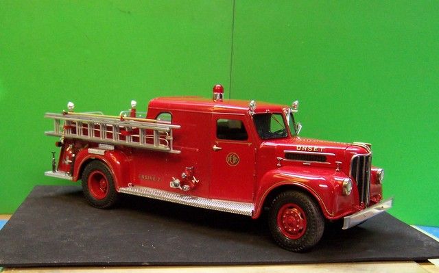

As you can see the details are beginning to pile up. The last one which was done yesterday is the turned aluminum siren on the left front fender. It has a photoetched grill work in the middle and the end was drilled out, filled with clear epoxy and then painted with Tamiya clear red for the lens. This side of the truck is essentially complete. Still to go on the other side is the ladder rack and aluminum ladders, an axe and brackets, fire extinguisher. On the rear the spotlights and hand rails need to be installed. Then the hose bed gets filled and then covered with "plywood" covers and canvas flaps. On the front the windshield wipers need to be made up and installed.

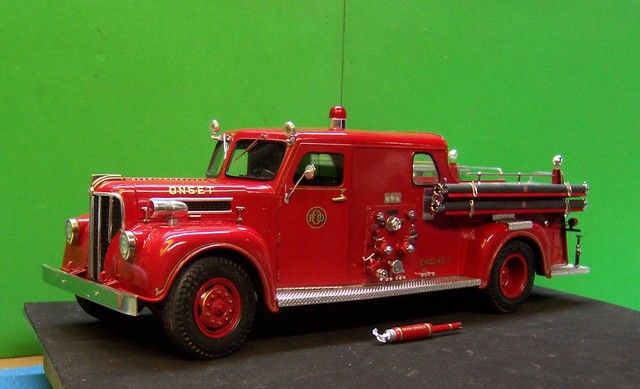

The little tool in front of the truck is the "Official Door Opener". I dressed it up a bit with an eagle and some gold leaf! :D
So instead of using fingers or tweezers to open the cab doors, you can just turn the handle with it and they will open.
The right side of the rig is pretty Spartan but that is the way the original truck was. Strictly business.

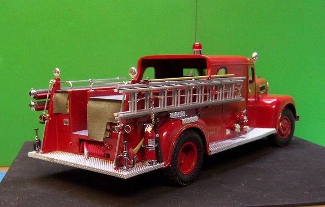

A look at the back shows the hand rails, tail lights, rollers for the booster hose, the extinguisher and axe all in position. The hose covers are sheet plastic stock made to look like painted plywood as the full size ones were. And they used sewn canvas as covers for the back.

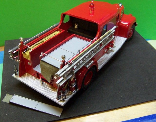

With one cover removed the hose load is open for inspection. It's not as full as it looks! The first two layers are short folded pieces about 1" long. Behind them is a plastic box. The succeeding layers are on top and helps to save on sewing elastic! The trolls didn't cheat, I did! 8-)
