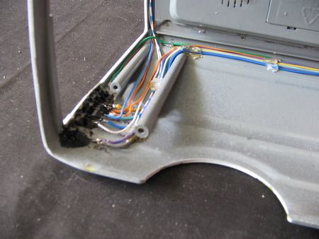

Postby Robbo on Sat Oct 03, 2015 9:43 pm
Hi all. A lot more progress. I have been able to spend quite a few hours on this project, since the last posting.
Most of the assembly and wiring of the various LEDs and circuit boards is complete. The rear cab light assembly is the last item to be fitted and wired. Is held in place with four 2mm screws.
Trusting that you will find of some interest.
Robbo.
The rear emergency flashing light assembly has alternating red, blue and amber lights (the latter also is used for turning indicators) as well as tail/stop lights. Has three spotlights, two at sides & one rear.
Rear cab with wiring to the triple red, blue & amber LED pulse circuit and relays that connect the amber LEDs to either emergency flashing or turn indicators.
Rear cab - stop, tail, reverse, turn and red emergency flash LEDs.
Rear cab - stop, tail, reverse turn and blue emergency flash LEDs
Main 'pulse producing circuit board for emergency alternating red & blue triple flashing LEDs as well as pulses for turning indicators. Board folds into cab cavity to fit flush for the front cab to be attached.
Front cab has head lights, turn indicators including filed down LEDs fitted into the rear view mirrors. Emergency alternating flashing blue and red LEDs in the front grille and in nacelles on top of the bonnet in front of the windscreen.
