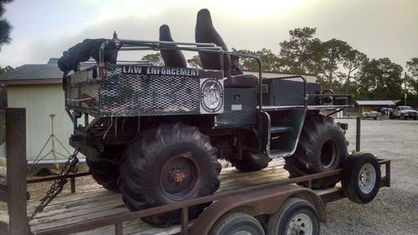

A smaller buggy used by Law Enforcement

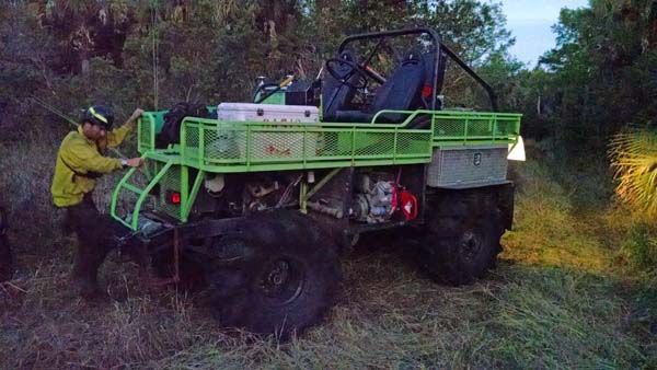

More of a suppression unit, this one had a 200 gallon tank and an 85gpm pump under the floor (pump inside the screened area at the back). Only 2 seats but can easily carry 2 or 3 additional firefighters sitting on the tool boxes.

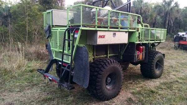

Similar buggy with a 3rd seat in the back and the pump mounted on the side

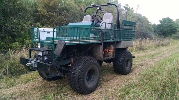

These are from a couple different buggys, but should give you some ideas. I didn't get a really good photo of the drivers area, but they all had a simple gas / brake pedal like a car, column shift automatic and a floor shift manual "transfer case" with either a standard H pattern (4 speed) or H+1 (5 speed) cut into the sheet metal of the floor between the seats. They are full time 4 wheel drive so actually have a 3rd gearbox providing power front and back buried somewhere in the driveline.
There is a raised cover on the front deck providing access to the top of the engine.

Last few, most of these had a fair amount of under deck storage for tools, fuel, drip torches etc.
